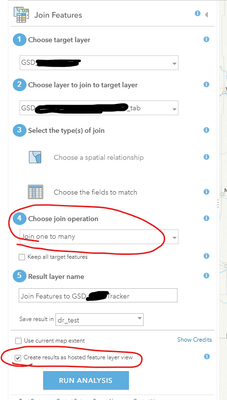

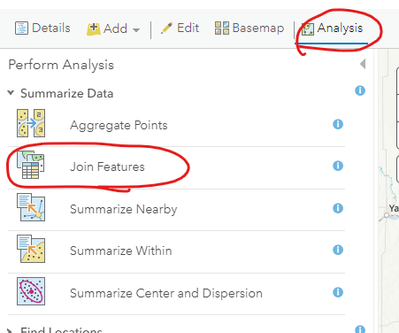

Hello
could you try to create a hosted feature view in map viewer using the Analysis/Join Features? That way you should have all your data into one layer to use within Dashboard.
Hope that works for you
