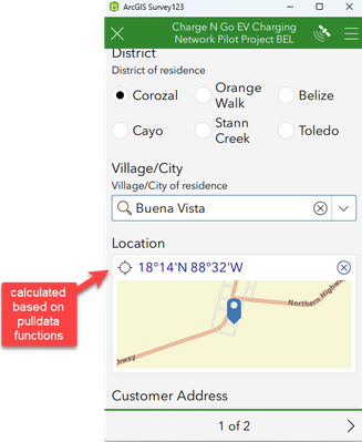

I gave a try to the pulldata function to map a point based on a selected community. This works on the survey123 mobile app but the browser version, it doesn't map the gps locations. Since this will be intended for a public data collection, we would rely on the browser version to fill in the info. Is this a known limitation? (Didn't find any tech arcticle stating this tho)
