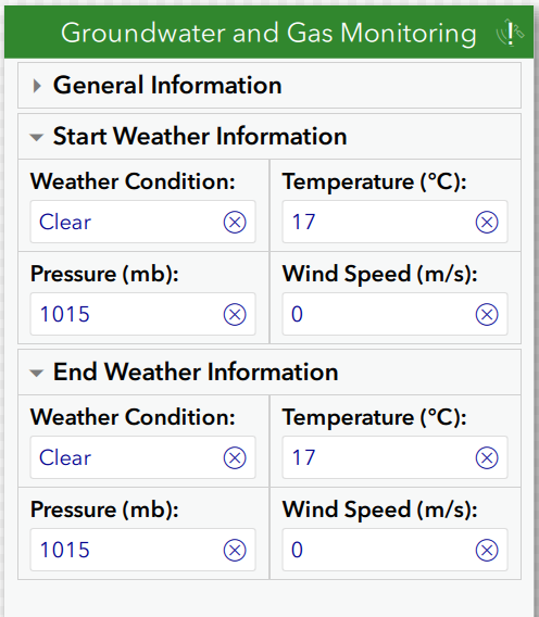

Hi all,
I am wanting to capture weather information at the START and END of a survey.
Currently the weather information for START and END is captured at the start of the survey, based on the users geopoint location and the OpenWeather API.

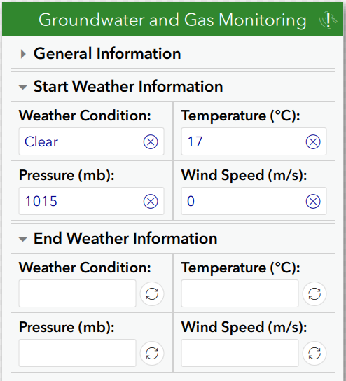

I was wondering if there is a way to delay the capture of the END weather data, and somehow include a trigger, eg a button, that can be tapped to pull the weather data through when the surveyor is near the end of their survey?
I can clear the end weather data by clicking the circle X button, and then refresh the values, but is there a more glamorous option?

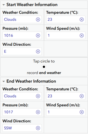

BenBlowers2
This works nicely, thanks @DougBrowning!
And after the button pressed:
