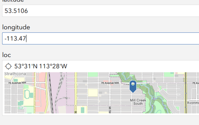

Hi, I'm trying to manually add lat/long to survey to map points. The locations look correct in the survey map but when I look at the point layer in web map, there is nothing there and there is nothing in the attribute table?  I'm sure it's something simple but I can't figure it out. Help? Thanks!

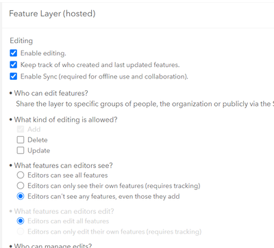

What are the settings on the feature service itself? If it matches the following allowing others to query will be disabled on the feature service causing the map viewer classic issue observed:
To resolve the issue you can set What features can editors see to either "Editors can see all features" or "Editors can only see their own features". You don't need to enable update or delete for "What kind of editing is allowed".

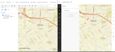

Looks to be working to me.

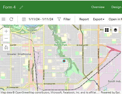

Field App:
S123 Website:
I had to remove the "read only" on the lat lon fields. It appears like the "enter vc" field is supposed to be a dropdown? I am wondering if the data being pulled from there has something wrong with it.

I included the .csv file that the pulldata is using to retrieve lat/long for vc that is entered. I was just displaying the lat/long to confirm the pulldata was working correctly. The map in the survey is showing the locations correctly.

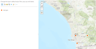

When I submit the survey, this is the data in the in the feature layer. When I look at the records in the feature layer and visualize it I see the points on the map:

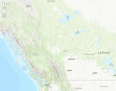

But the web map doesn't show the locations

Assuming you published your survey from Survey123 Connect in a version later than 3.14, if you didn't enable the inbox or allow sent surveys to be edited before initial publish, the feature service Survey123 creates will have the query capability disabled. There is a BUG in the old map viewer that prevents the data from displaying if query is disabled.

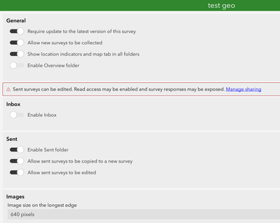

Still confused as to what is going on. I'm using Survey123 Connect v 3.19.104. Prior to that I had surveys working to send feature layer info that was displaying and showing up on dashboards. Now nothing is working. These are the settings in the survey and if I try creating a dashboard using web map (with the test geo feature layer) nothing is showing.  Does this have anything to do with using Portal? We a using 10.9.1 version of portal. I had a few surveys working a few months ago using Survey123 Connect v 3.18 and I didn't need to enable the settings to allow surveys to be edited or copied - I don't want my users to be able to do that.
