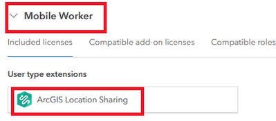

As I'm sure you know, Mobile Workers get Location Sharing by default. As such, you should see this under Organization > Licenses > Mobile Worker
While rare, this may still be an issue with the licenses. In the past, we've had to get Esri to recreate our licenses due to an odd bug on their end.
