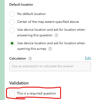

Edit:  If only using the webapp I would play with some of the settings in the attached image and make it a required question
