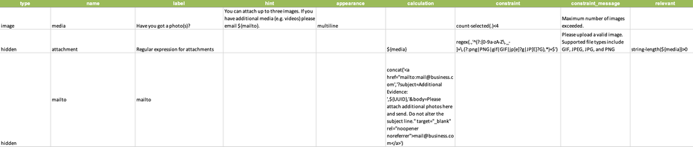

I'm using a concat() to construct a mailto link for the hint of an image question. This link works in Connect and the field app, but not the web app.
concat('<a href="mailto:mail@business.com','?subject=Additional Evidence: ',${UUID},'&body=Please attach additional photos here and send. Do not alter the subject line." target="_blank" rel="noopener noreferrer">mail@business.com</a>')
Table for concat() link exampleTable for concat() link example

That's right @Anonymous User, the mailto link is shown but doesn't open. As far as I'm aware, this has always not worked. I can right click and there is a 'Copy Email Address' option however.
Please see attached a simplified version of the XLS Form. This repros the problem in my testing.
