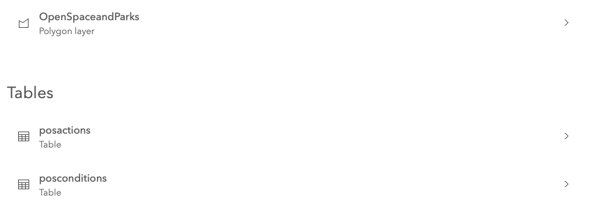

First, is the hosted feature service created from Survey123:

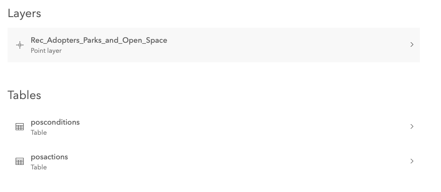

Second, is the feature service I created in Catalog and uploaded to AGOL and am trying to link the survey to:

The form_id in the setting sheet needs to match the top level - so here should be OpenSpaceandParks to match the new service.  The repeat names seem to match ok.
Oh wait you also have 123 as a point layer but your new service is a polygon layer.  I cannot tell though if you are trying to match the layer also or just the tables.
Then I think you need to remove the parentglobaid here as 123 makes and maintains those itself.
You basically just need all the fields and names to match up to the new service.  I am not sure why you are making a different service either if it matches the form.  Sorry you are kinda of losing me here.  My method assumes you have several forms and one master layer all pointing to one big service.  Each from goes to each related layer it is not one big form that has the entire service in it.
