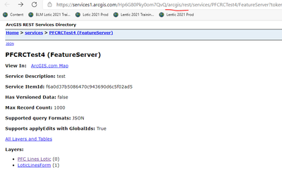

Well I got some of it.  The  /ArcGIS/services part needs to be lower case /arcgis/services.
I got this because the rest is diff if you go to a layer vs the top level of the service
Top level
But the layer is goes caps
Now that's crazy.  Seems like a bug to me.
So now I get farther but it still asks me which layer and will not pass in any attributes.
Any ideas why it makes me tap the layer name?  It is not passing any attributes because of this.
Edit I got it to pass attributes but I still need to tap the layer name in-between.  Not sure why.  Collector does this also though.
