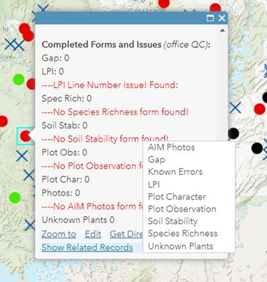

Take a look at the FeatuteSet functions in Arcade.  I do this all the time to lookup data in a child or parent, find the last inspection date, even summarize points in a polygon all on the fly.  Pretty slick.  https://developers.arcgis.com/arcade/function-reference/data_functions/#featuresetbyname

I just use Filter which is just a SQL query lookup to any layer based on the name in the map.
In this case here I am looking up a value from the parent.  I know there is only one parent so just one return - so I can use first.
var sql = "PointID = '" + $feature.PointID + "'";
var tbl = Filter(FeatureSetByName($map,"Points", ['DesignLat'], false), sql);
return First(tbl).DesignLat
But you can also use if
var EvaluationID = Concatenate($feature.PointID, "_", text($feature.FieldEvalDate, "Y-MM-DD"))
var sql = "EvaluationID = '" + EvaluationID + "'";
var tbl = Filter(FeatureSetByName($map,"Floodprone Width", ['EvaluationID'], false), sql);
if (count(tbl) > 1) {
    return "More than one form found"
else if (count(tbl) < 1) {
    return "No forms found"
else {
    return "1"
Or loop through them
var index = 0
var last = ''
for (var f in OrderBy(tbl, "UnknownCode")) {
    if (f.UnknownCode == last) {
        Dict.features[index] = {
            'attributes': {
                'dups': last,
        ++index
    last = f.UnknownCode
Hope that helps.

No you cannot use Arcade to symbolize.  Prob its biggest weakness.  Its a speed issue.  Imagine having to run all those Arcade at once for a map display.  Same thing with the attribute table, just too slow.  So yes it gets limiting.
It is mostly for popups
I would also look into the new Attribute Rules coming in Field Maps - in beta now.  We also go old school sometimes and run a Python script each night to update values.
