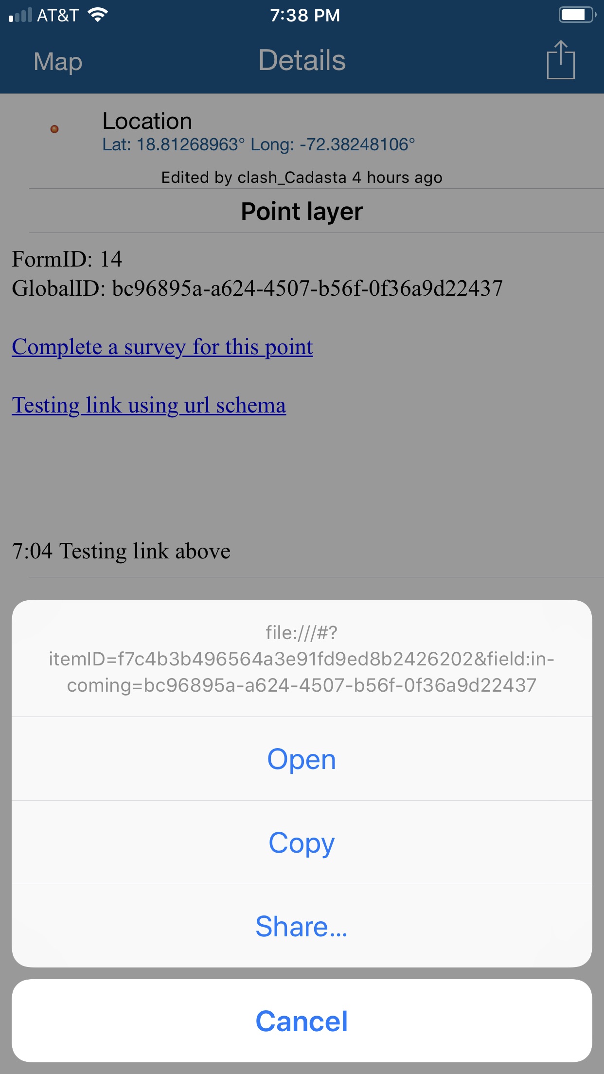

ChandraLash
Thank you for the information but I'm now having the same issue as this unanswered question. Basically the url scheme is replaced in the Collector link to be a #.
Any ideas on how to fix this?
