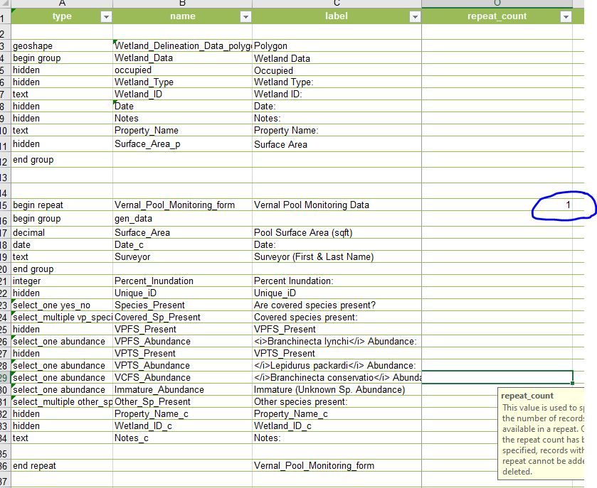

Hello, I currently have a form created in Connect that utilizes a relational feature service.  The form collects new data for the related table.  I have a repeat setup to add data to the related table and would like to limit it to only allow 1 record to be entered.  Does anyone have an idea as to how this can be done?

Thanks Chris for your quick response.  I have tried adding a number 1 to the repeat_count however, I get an error stating that there is not a matching field in the existing feature service.  Is there a way to enter this value without having to have a matching field in the data?

Thanks. That warning may be unrelated - did you add additional questions (i.e. fields that weren't included in the original feature service schema)?
Also please note you have two data validation issues with the names - 'Date' is a reserved word and row 2 is too long (keep field names under 30 characters)
icf_Eric_Link
Thanks for catching the Date issue.  Regarding the length of the field names row 3 is the name of the existing feature service I am connecting to and row 15 is the name of the related table.  I have not added any new fields that were not included in the existing feature service.
When I delete the "1" from the repeat_count cell I can successfully publish the form so I'm thinking entering a value in the repeat_count cell is some how causing the problem.

It looks like the repeat_count is stored in the parent table schema as a field. Further discussion and solution here:

After looking into this issue more and understanding exactly how repeat_count works, when using a static value in the xslx form for repeat_count, a new field will automatically be added to the feature layer to store the value entered. This is required so that the field app can retrieve the stored value to then load the correct number of records in that repeat.
Therefore you will need a field in your feature layer called ${repeatname}_count where the ${repeatname} is the name of your begin repeat question that has the repeat_count applied. This can be created as read only and even hidden so that it is not displayed on the form in the field app.
This expains why we are getting prompted around adding a new field.
As it's a feature service, I believe the solution would be to add a field to the original service called {repeatname}_count, where repeatname is the name of the related table.
Please let us know how you go.
