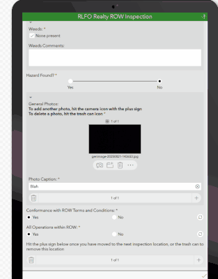

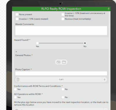

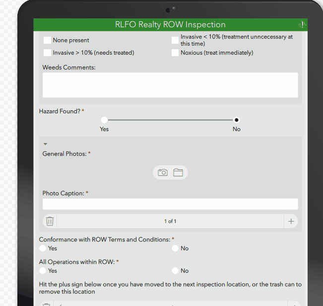

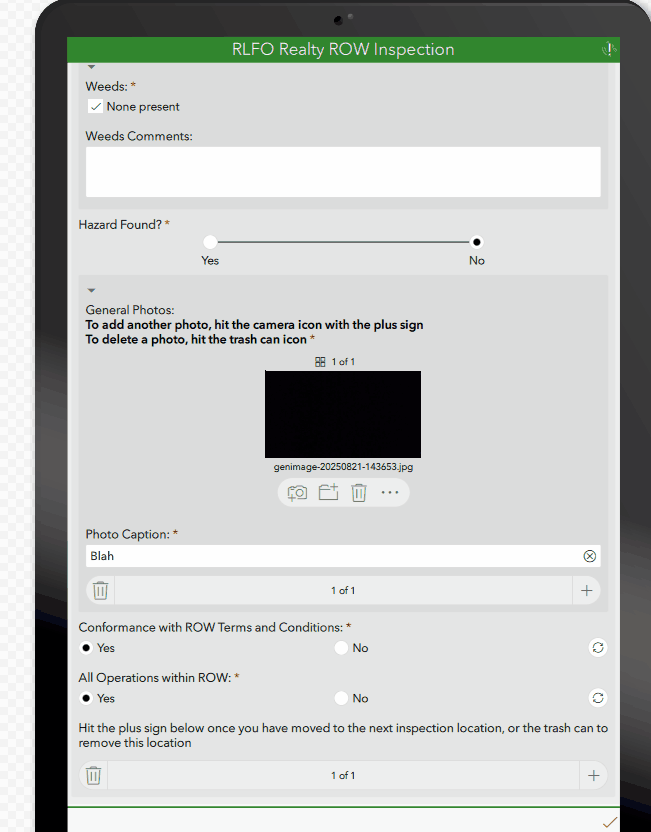

I'm running into this thing where the screen jumps up a question or two after submitting an image question.
Same thing for a repeat. It jumps up, but not to the top of the repeat.
How can I make them 1) not jump and 2) jump to where I want?
