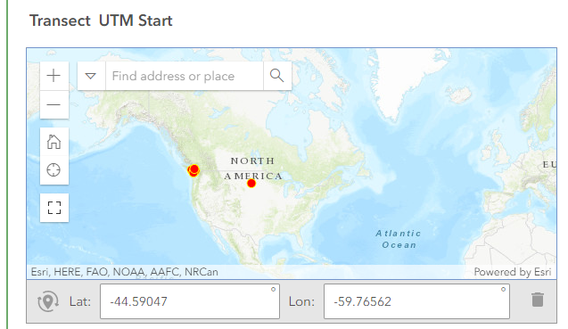

I have noticed that there are some differences in surveys between web form and mobile version.
1. For geo point, all of previous survey points are displayed. This is not observed in the mobile version though. Is there anyway that I can hide the existing survey points on the web version?

Hello Shwu-Jing, I am sorry for any inconvenience. I am not sure what happened to my previous reply. I hope this works!
The first image, you can see that there are some points displayed. they are from previous surveys. I am not sure why they are shown in the new survey form. Is this because of using web form?

Thanks and now I can see the screenshots. Did the issue occur with any version of web browsers you tried to access to the survey? Did you try chrome, firefox and Edge and encounter the same issue? What version of the suvey123 Connect you used to publish the survey? And what version of web app did you use to open the survey web form(the Settings page on the survey123 website)?
==> For showing existing points, it does not show on Edge (did not try before), and not in Chrome (what I use usually) either. I am wondering if this happened because of cached images? I just tested again, opened feature layers and map, and then opened the survey again. But I do not see this issue anymore.

Shwu-jingJeng
Hi Jay,
Thanks for the updates. It seems like there are some cache issue with your web browser. Good to know that you don't see the #1 issue anymore.
