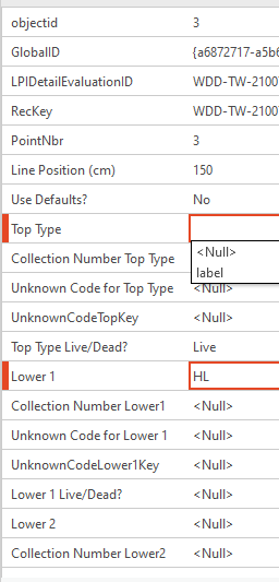

Running into an issue with the new search appearance and domains.
For some reason when using the search appearance 123 is creating a domain with the word label in it.  I think it is creating this from the choices sheet.
This is breaking editing in the web map and ArcPro.
WebMap you are totally stuck
In ArcPro it goes red and creates a hard stop both in the attribute table and in the attributes window.
This causes us to not be able to edit our data - even other fields!  Totally stuck.  Only workaround is to use field calc.  This is fine for advanced users  but basic users are totally lost on the red errors and it is causing us lots if support calls.  We can turn it off but the QA people hate that.

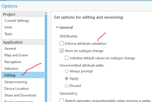

For now we have to turn it off totally which is not ideal.
