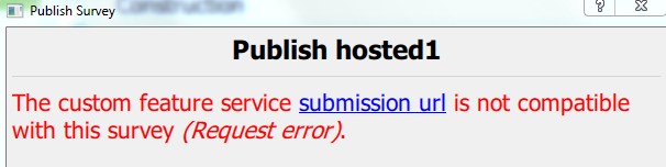

I'm getting the following message when trying to refer to our own hosted feature service while publishing a new survey:
'The custom feature service submission_url is not compatible with this survey'
I've downsized the survey to only one textbox and an integer question. My environment: Oracle SDE, AGS 10.4 (and 10.1 tried as well), https or http - both fail.
When comparing the auto-generated hosted feature service definition with my custom one, there is nothing obvious except minor differences:
-do Upper/lower case play a role in the column names?
-Tags 'Object ID Field' and 'Global ID Field' are missing in the custom definitions (but the field are available and managed by the database
Are there any specific attributes needed when switching the submission_url?
Any input greatly appreciated!
