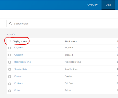

ZacharySutherby
Hello @AugustPaterno
Would you be able to provide a screen capture of the issue? When you say the output map says something different is that in a web map? If it's a pop up in a web map that will be pulling from the alias of the feature service you can check by navigating to the item details page for the feature service the survey points to > select the Data tab > Select Fields. What does the Display Name say for the corresponding field?
Thank you,
Zach
