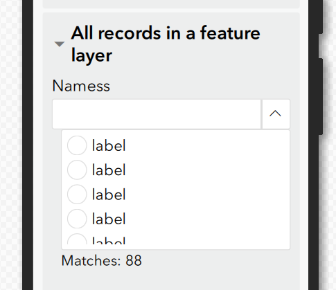

I am trying to connect a hosted csv file to one of my surveys, but when I try to select an option in the survey, all the options appear as "label" instead of the actual data from the file.
The csv has been uploaded to my ArcGIS Online account and linked to the survey. The number of matches in the pull down also equal the number of items within the csv file so I know it is reading something correct. Any ideas what could be causing this error?

Do you have a name and label column in the CSV?  Kinda flying blind here without the form.

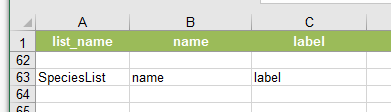

If so did you add the column mapping in the choice tab like this.  That tells it which columns to use in the csv since they do not have to be name and label.
Hope that does it.

I think I updated the code to include column mapping in the choice tab, but the issue is still the same.
