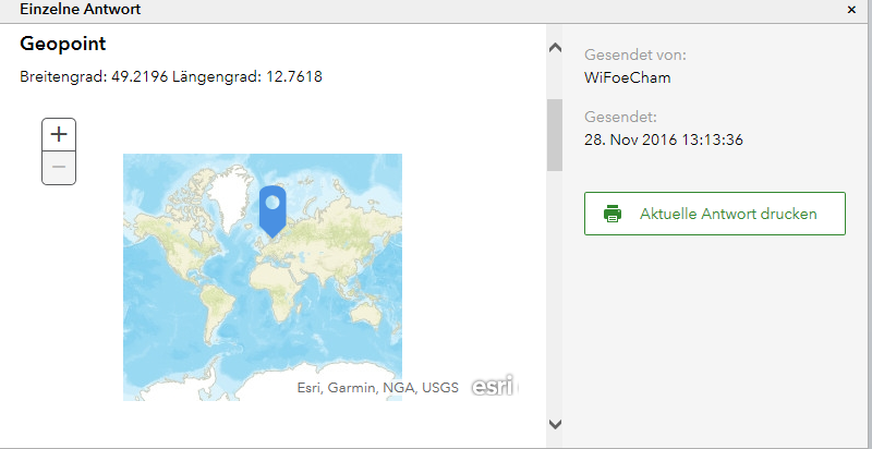

Is there any way to usw my own created basemaps in the survey123-Report ?
And is there also a way to Change the formal Settings of the Report?

 - Open ArcGIS Desktop (ArcMap or ArcGIS Pro)
 - Add your own data (basemap + other layers)
 - Create a Tile Package in Web Mercator (Auxiliary Sphere)
 - Associate your own Survey with this Tile Package
For more details, check Prepare Basemaps for Offline Use

Just to add onto Jayanta Poddar‌'s reply, here is the help topic link,
Prepare basemaps for offline use—Survey123 for ArcGIS | ArcGIS
