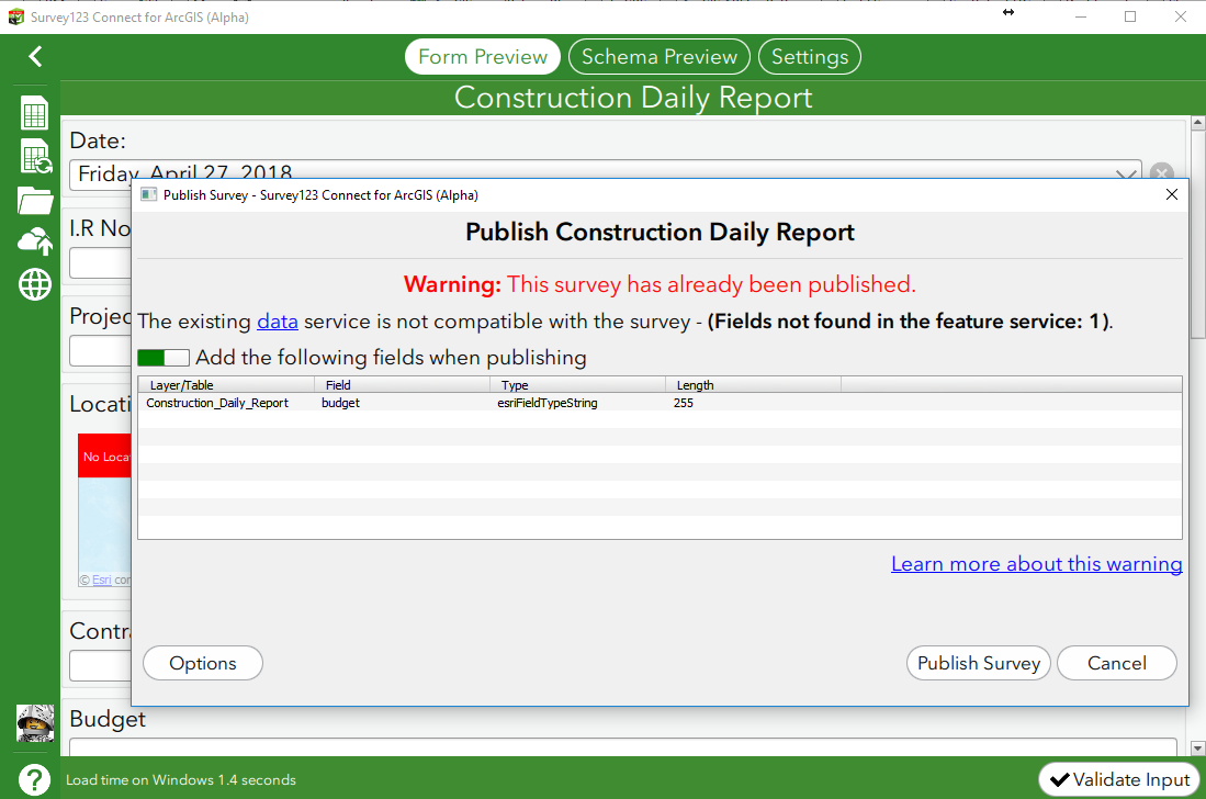

Hi. Can you check your version of Survey123 Connect?
With version 2.7, Survey123 Connect can add the necessary fields in the feature services without overwriting your data.
In the old days Connect would always delete your service and recreate a new  one, but that was some time ago...
The only exception to the above rule is if adding new geopoint question within a repeat that did not have it before. Connect cannot add a SHAPE field into an existing feature layer.
JuanPeralta1
Hi Ismael. Is that feature still available?
I have Survey Connect 3.2.196 and I cannot see the option to add the missing fields when I try to publish a survey with a new text field. My "Publish survey" form does not include the option ""add the following fields when publishing".
Does the feature service have any specific requirement?
JamesTedrick
Esri Esteemed Contributor
Hi Juan,
Did Survey123 Connect create the feature service when the form was initially published, or was it using an existing feature service?  If it was an existing feature service, there is not the option to add additional fields.
JuanPeralta1
Hi James,
the feature service was created from ArcGIS Pro, before publishing the Survey, so that's the reason. Thanks for your feedback.
