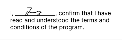

Here’s an example screenshot of how the statement will look with the signature.
