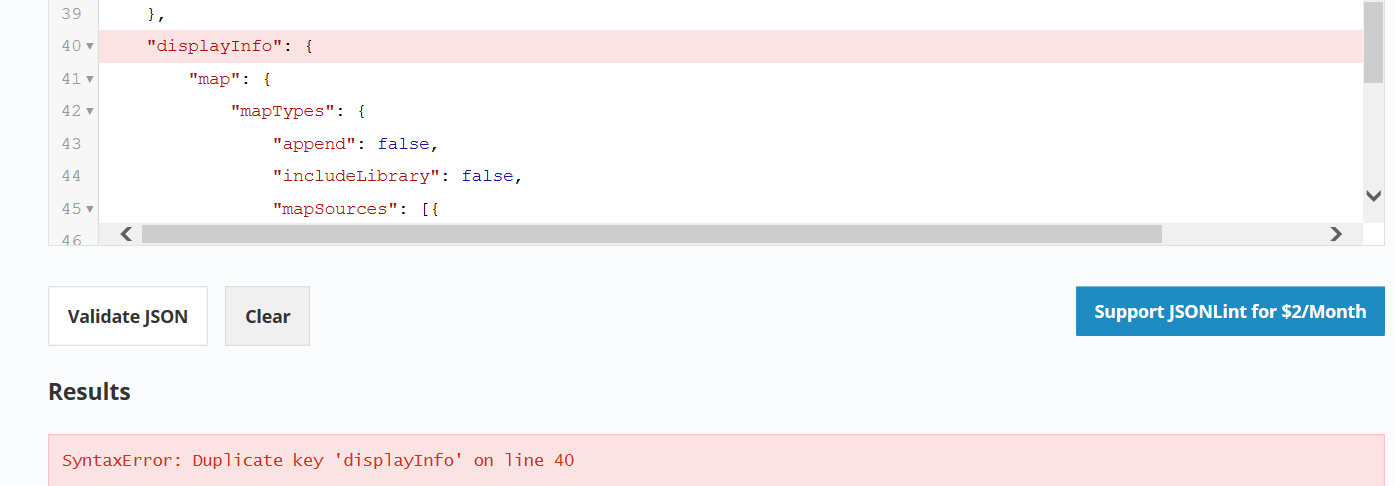

I am trying to modify the JSon code from Esri to enable me use my offline map on my survey 123 for ArcGIS design "http://doc.arcgis.com/en/survey123/desktop/create-surveys/preparebasemaps.htm"
But I am having issues with the validation, I am just stuck on one '{'
I am not very good with JSON syntax and I need to get the syntax right for the script to work. I would appreciate if anyone can spare a few seconds to look at the script and help me find what I'm not doing right.

Here is the error from JSON Validator (Screenshot)
Screenshot of Error from JSON Validator

Anyway...in a Json file you must have a unique "key value"...instead you have 2 "displayInfo" key in your Json

As Stefano says, you have 2 'displayInfo' sections.  You should combine them together to make one section:
