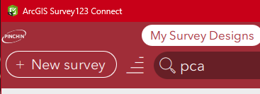

I want to say that I wish it was more obvious that I wasn't logged in
Good news! It can be. You just need to configure it in the S123 web Site and Portal:
My Connect is red when I log in, because that is my company color:

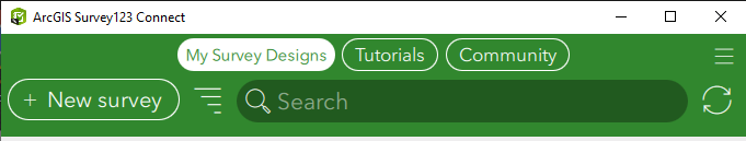

I turned on "Use Organization's Shared Theme" but when I login, the color for Connect doesn't change. I think that this means that we don't have a custom company color. I will ask a co-worker about that. Or, do you happen to know where that setting is? Thanks.
ChuckS
We just updated the shared theme colors and now I immediately know when I'm logged in or out of Survey123 Connect. Thanks for your help!
