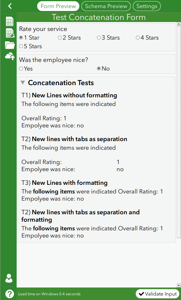

I want to provide dynamic feedback in a note that summarizes the responses. I have been successful in deploying these summaries with both newlines (\n) and tabs (\t) in the concatenation formula (concat). When I try to add some formatting to the concatenation, it breaks the newline and tabs, so that everything appears on one line.
I have attached a form to test this. In the results, we can see that adding some bold text to the concat causes an issue.
Is it possible to apply formatting in the same concatenation form that a newline appears?

Hi Elliott,
I have had a look at your form and this behaviour looks to be a bug.
We will get this raised internally.

FYI I got this working using something like the below:
concat("<font color='red'><b>HORIZONTAL ACCURACY OF ", ${HORIZONTAL}, " IS INSUFFICIENT</b><font>")
This picks up the red and the bold tags. Weirdly though, if I try the below it refuses to pick up the center tag:
concat("<center><font color='red'><b>HORIZONTAL ACCURACY OF ", ${HORIZONTAL}, " IS INSUFFICIENT</b><font><center>")

Thanks! Another workaround is making many note fields without a field name so they're each listed on a new line.
