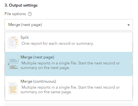

When a feature report is generated on the Survey123 management site, there is an output setting that allows reports for multiple records to be split into multiple documents or merged into one:
However, in the Generate Report action in Power Automate, that setting isn't available or it's at least not obvious. I'm setting up a scheduled flow to run once a week on all records submitted the prior 7 days and would like to merge them into a single document. Is this possible with the Survey123 connector or are there any simple workarounds?

I believe that this is not an option in the power automate action.
I was able to implement as an http action using a POST request:
Report | ArcGIS Survey123 REST
It has a paramater for merge:
mergeFilesfalseSpecify if print multiple records into a single report file (merged mode) or multiple files (split mode), and if in merge mode, start the next record on a new page or continue with the current page. Note: A merged file larger than 500MB will be split into mulitple files.
  • none: Print multiple records in split mode, each record becomes a separated report file. This is the default value if mergeFiles is not specified in the request.
  • nextPage: Print multiple records in merge mode, the content of the next record starts on the next new page.
  • continuous: Print multiple records in merge mode, the content of the next record starts on the same page of the previous record.
