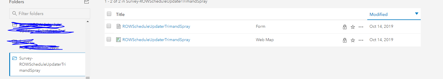

When I create and publish a survey from an existing feature service, it creates a folder containing a web map and the survey form. This is the one I am not able to edit repeats on.

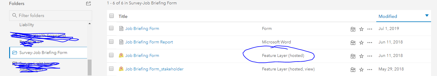

For this survey, I am able to edit repeats after it has been submitted. This was created from a new survey.
