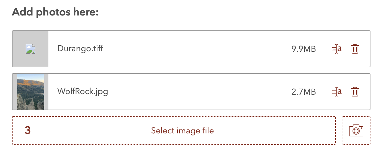

I recently tried adding a TIFF image to my survey and it is not working. JPG's and PNG's work fine. See attached. It shows a placeholder but no image.
This is happening in all surveys I'm working with. Also, I designed them using CONNECT.
If this continues to be an issue, is there a way to limit the user from trying to add a TIFF image? Using Constraint or something else?
