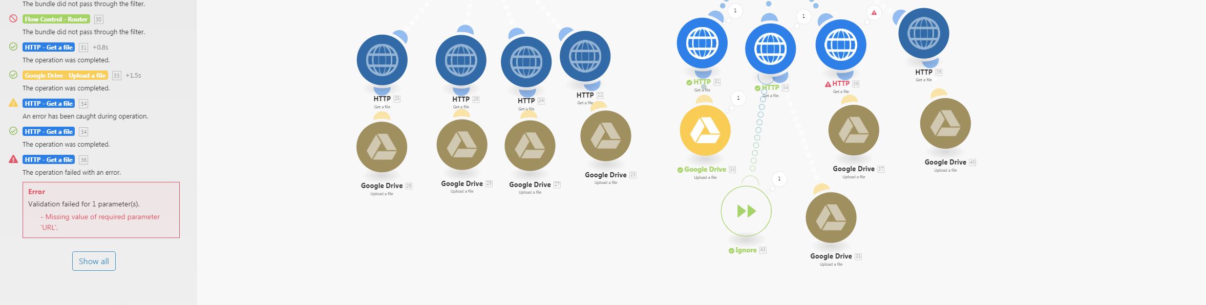

I am trying to configure an Integromat scenario that takes the photos of each S123 and stores them on a Google Drive File Share. When I run the scenario I am given a error that states "Missing value of required parameter 'URL'." and the scenario will turn off in Integromat. Any clues or suggestions on how to resolve this issue?

I saw a similar issue with one of my scenarios when I didn't account for a missing value. So in your case it looks like there may be a missing photo so the scenario doesn't know how to account for this and errors out. Adding an Error Handler (by right-clicking) on your HTTP Get File module will be worth a shot. Hope this clue helps. Below is a screenshot of a scenario I have with added Error Handlers for each HTTP Get File module (I'm capturing images to attach to email).

Thanks for the response. I had a quick question on the "Add error handler" option are you just selecting the "HTTP" module once again and specifying the attachment info URL to each individual photo? I am not sure if I select the "Directives" available options.

No, I'm just adding an error handler to the HTTP module that already exists. If I understand your flow, you have an HTTP module for every image question in your survey123 and subsequently a Google Drive module for each of those HTTP modules. This assumes that your image questions will have an image entered. When there is no image captured, I believe this is where you are getting the error since that's what I saw with one of my own scenarios. In my case, when an image is not captured the Error Handler diverts the scenario to a new email module to send an email without image. In my posted screenshot you can see the Error Handlers by the path with unfilled circles from the HTTP modules.
NOTE:
You might be able to not use Error Handlers if you force your image questions in survey123 to be required although I'm not sure if that'll work for your survey.

I was able to figure it out with the attachment issue not liking Google Drive when I didn't use all four of my photo options within S123 by using the "Ignore" function as the error handler on the HTTP Request for Getting a File. Not sure if that answers your question.
