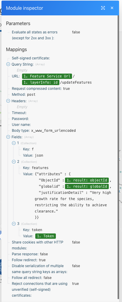

Trying to update feature attributes using these parameters:
  • Key = f
  • Value =json
  • Key = features
  • Value = {"attributes" : { "ObjectId" :1. result: objectId, "globalid" :1. result: globalId, "justificationDetail" : "Very high growth rate for the species, restricting the ability to achieve clearance." }}
  • Key = token
  • Value= 1. Token
integromatHTML_paramaters_001

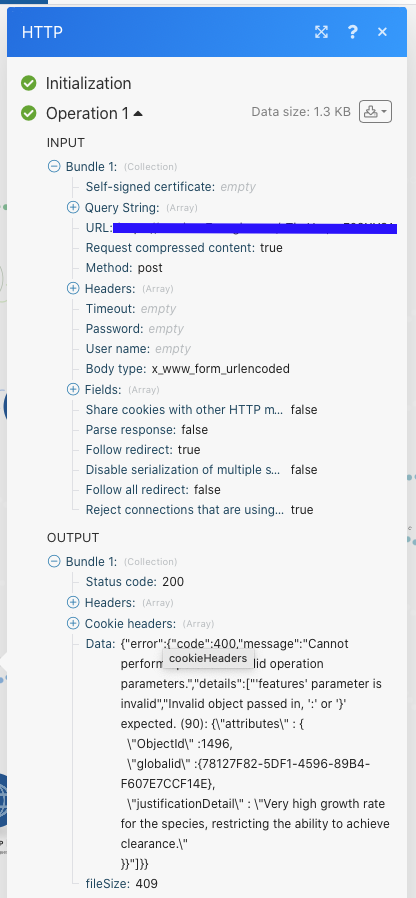

But I get this message:
  • Data : "error":{"code":400,"message":"Cannot perform operation. Invalid operation parameters.","details":["'features' parameter is invalid","Invalid object passed in, ':' or '}' expected. (90): {\"attributes\" : { \"ObjectId\" :1496, \"globalid\" :{78127F82-5DF1-4596-89B4-F607E7CCF14E}, \"justificationDetail\" : \"Very high growth rate for the species, restricting the ability to achieve clearance.\" }}"]}}
IntegromatHTTP_outputmessage_08042020

I would encourage you to use Apply Edits (Feature Service/Layer)—ArcGIS REST API: Services Directory | ArcGIS for Developers, which is a more robust editing resource.  Note that the in the UpdateFeatures resource, the features parameter is expecting an Array - even if you are only updating 1 feature, you need to provide an array [ ] object.

This was the error:
{"error":{"code":400,"message":"Cannot perform operation. Invalid operation parameters.","details":["'updates' parameter is invalid","Invalid object passed in, ':' or '}' expected. (90): {\"attributes\" : { \"ObjectId\" :1499, \"globalid\" :{8AE51921-D053-440C-8533-949A2B778DA5}, \"managedCost\" : 116.36 }}"]}}
I'll keep investigating, thanks for your help.
