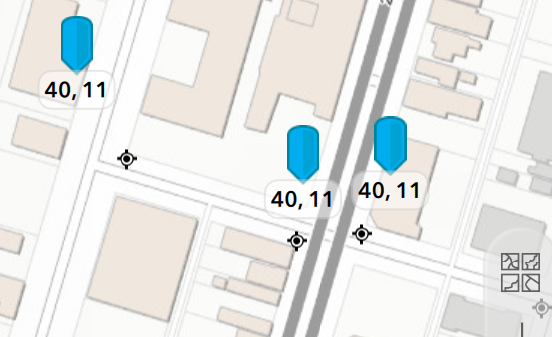

Inbox map does not display points in correct location when using Standard map setting, although the pin is correct in the map preview of the form. This doesn't occur on a windows desktop, only on Panasonic toughbooks, I have tested on more than one. Is it a resolution problem?I have tried changing the screen resolution on the laptop but it still occurs. If I switch back to Basic map in the settings they are in the correct location. i have also tested on Android and IOS with no problems.
UPDATE: icons move as you pan the map. The Icon is only in the correct location when the location is in the center of the map view.

I can see the same behavior you described. Please note that standard map type is still in Beta function. Thanks for reporting this and we will look into this further.

I have one question for you. Could you check your device setting to see if you change the scale/layout size, which affect the size of text, app and other items?
We notice that when the scale and layout on windows set to over 100%, for example, 125%, the floating issue is obvious.

Sorry for jumping on an old thread but I've just come across this issue myself. I can confirm that in my case the text scale was set at 100%. I tested on two devices and found that the issue occurred on an 8 inch samsung tablet but didn't occur on a 5.5 inch phone. Is this issue device specific then?
