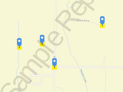

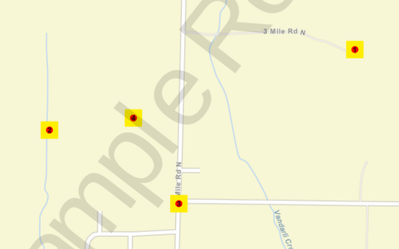

I have similar but different issue in a feature report from Survey123 and it has not been solved. I tried to define the symbology in the feature layer created by my Survey123 form and it ended up very weird. I defined the symbology in the feature layer but when I ran the report, the default symbology (yellow outline, red circle) would show up WITH the symbology I chose. In other words, both symbols were mashed together. I worked with Esri Technical support and understand it is connected with the enhancement ENH-000123894
This only happens if you change the syntax in the report template to something like ${location | size:650:650 | drawingInfo:“currentLayer”}
Default report output if you define the symbology in the feature layer
