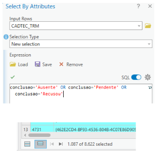

I have a query clause in the Inbox, however, it does not return the same records when I compare it to queries made in ArcGIS Pro:
Survey123: 1,031 records
ArcGIS Online/Pro: 1,087 records
I've already tried some SQL combinations and they all return the same difference in values. Some of the tests carried out:

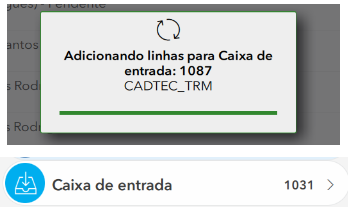

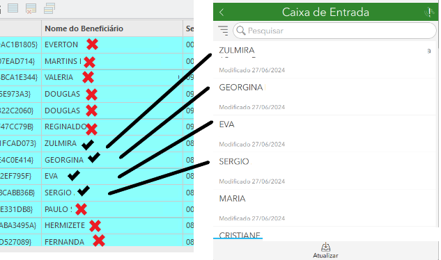

I noticed that many of my most recently edited records do not appear in the Inbox in Survey123:
I also noticed that when updating the inbox, the correct value (1,087) is displayed in the popup, but at the end of the process, only 1,031 are displayed:

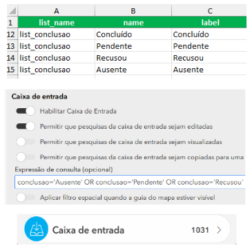

SMH-Rio
No, I do not have Sent enabled in Connect, nor do I have any records sent in the Field App.
I even created a new test form (with a much simpler structure than the original), pointing to the same layer, and the error persists. The form settings follow:
SMH-Rio
Update: I created a visualization layer with the filtered records and removed the query from the Survey123 settings and the problem still persists.
In other words: there is no problem with SQL syntax, domains or anything like that. For some reason, the input box is not returning all records from the layer.
