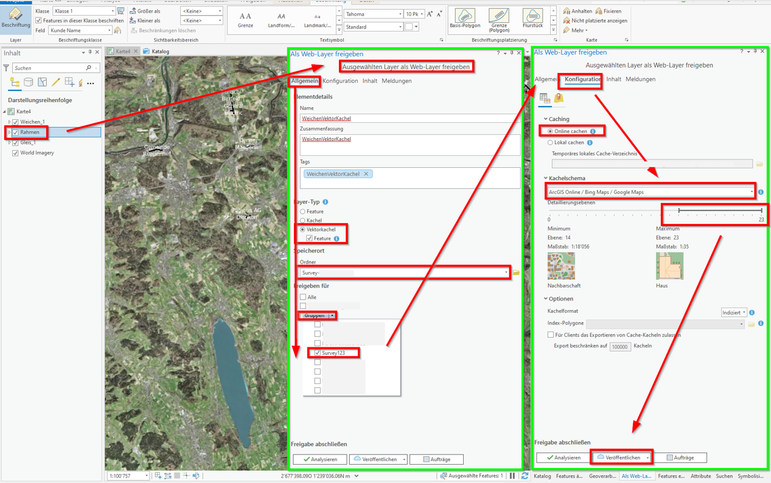

  1. In ArcGIS PRO publish my featureclass as Web-layer:
    1. Type: VectorTileLayer
    2. Set for Arcgis Online the Folder and the Group
    3. Caching: Online
    4. Tile Scheme: ArcGIS Online/Bing Maps/ Google Maps

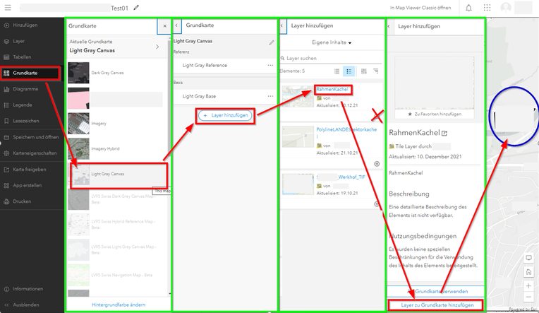

  2. In ArcGIS Online I create a new Online Map in the right folder and Group:
    1. Basemap: "Imagery" (the standard Basemap from ArcGIS)
      1. Layer insert: I insert the published VectorTileLayer "inside" the basemap menu.

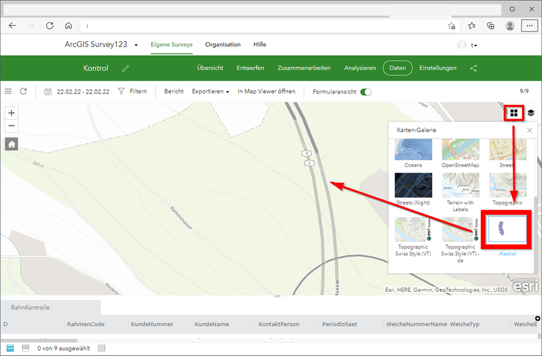

  3. In Survey Web I can see the Basemap Tumbnail in the menu, I click it and the Basemap (imagery) is loaded but not the VectorTilelayers.
  4. Something important to know: In Survey123 App (Android) everything is loaded.
