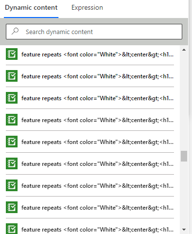

However! Sometimes, neither the question name or label shows up in the search, especially if in a repeat table. For example, I have one text question in a repeat named "bmp_existingBMPother" and the label is "Other BMP Notes". This is not a hidden question, but in the dynamic content, it shows up as "feature repeats <font color="White">&lt;center&gt;<h1>BMP Inspection Survey</h1>&lt;/center&gt;</font> attributes Other BMP Notes". This does not show up in a search of any thing unless I start with "feature repeats <font....". This makes it impossible to find the right attribute.
Now, the bigger issue is that the width of the dynamic content window is too narrow to display this elaborate question name/label, so I can't tell what it is. No tool tip pop-up, no scrolling. So it's a wild guess. And there are a lot of these repeat fields since there are multiple repeat tables in the survey. Here is a screenshot of what that looks like:

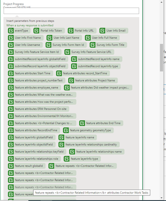

CarlisleHaworth1
