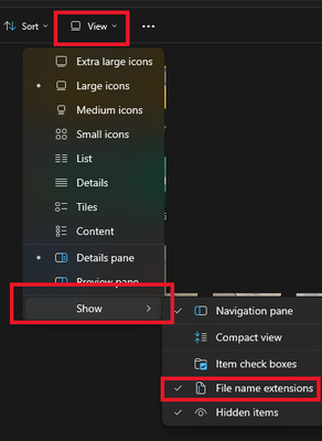

Do you have File Name Extensions visible? That also needs to be an exact match.
ijr
I didn't have the file extensions, added those and it worked. Thanks!
