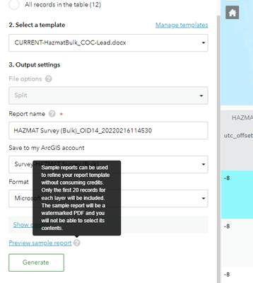

DerrickWestoby
I was under the impression that all reports use credits, even if you're using the default/auto generated template. I've never actually looked into that, but I don't imagine that ESRI would charge for custom report templates but not the default one.
The "Preview sample report" option does not use credits though.
