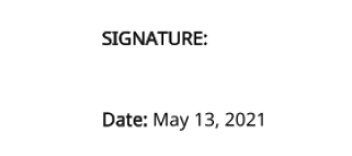

My Survey123 (created in Connect) reports are not displaying an image (a user's signature); it shows up blank when reports are generated, and no possible fixes have worked so far. This survey has been working properly for the past 5 years up until recently. Thankfully, we're still receiving submissions.
The template syntax that worked previously is: ${image}.
Has an Esri update introduced a new bug? And are there any potential workarounds for this issue?
