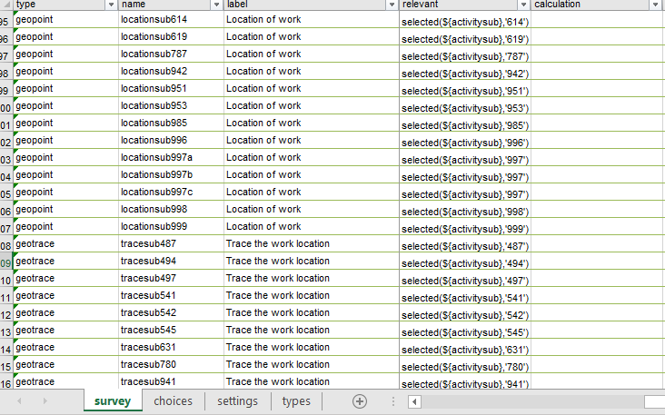

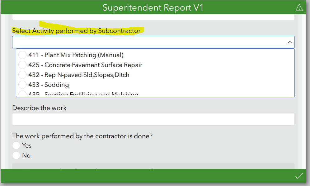

I'm S123 connect trying to figure it out something that I believe that should be fix with an if statement. I did a workaround but my survey takes some time to upload, maybe there is a better solution and I haven't found it.
Basically I have a survey question with multiple choices that contain activities description. The user only need to select one.
Based on the selection will show a geolocation or geotrace.
I get it to work by adding a lot of geopoint and geotrace functions in the spreadsheet but it takes sometime to upload because of the amount of data in it.
Maybe there is a better solution by doing an if statement in the relevant? Don't know if there is something like that around.

CesarAvila
Hi Jing.
The workflow is that the geotrace or geopoint will be based on the select_one for the {activitysub} (there are 51 answers). It matters what they select because that will trigger the geotrace or geopoint.
As an example below: If the user select 411, will trigger a geolocation. If the user select 494 will trigger a geotrace.
I was able to get it to work but takes sometime to upload because I have 52 geopoint/geotrace rows in my spreadsheet.
It would be great that you can put several relevant answers instead of only one. Something like this: selected(${activitysub},'425' or '425' or '432' or '433' or '436' or '499' or '530' or '612' or '787)
Jing_Sun
Hi,
I think you can use 'or' to group a number of selected() functions.
selected(${activitysub},'411') or selected(${activitysub},'425')
