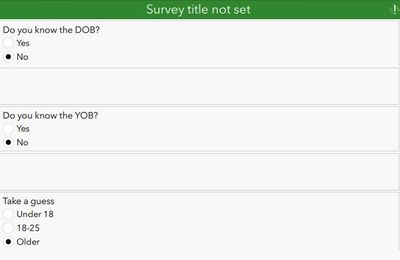

LaurenceTait
This is effectively a reductive series of answers. I've found it's clearer in these cases to ask a series of reductive questions, rather than evaluating whether a required answer has been populated.
The problem with evaluating whether another answer has been populated is that when the survey is first answered, no answers will be populated, so all questions will be visible. Users will then attempt to answer the first question to the best of their ability. In this case they will put something into the answer for the DOB question. This will then cause the next two questions to become invisible before the user has a chance to read them, and users will never realise they had a choice to specify that the answer is a guess.
So I'd avoid using hiding questions based on whether other questions are answered. It is very little additional effort to explicitly ask what level of knowledge a user has and then display the appropriate question.

LaurenceTait
