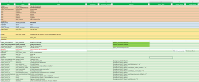

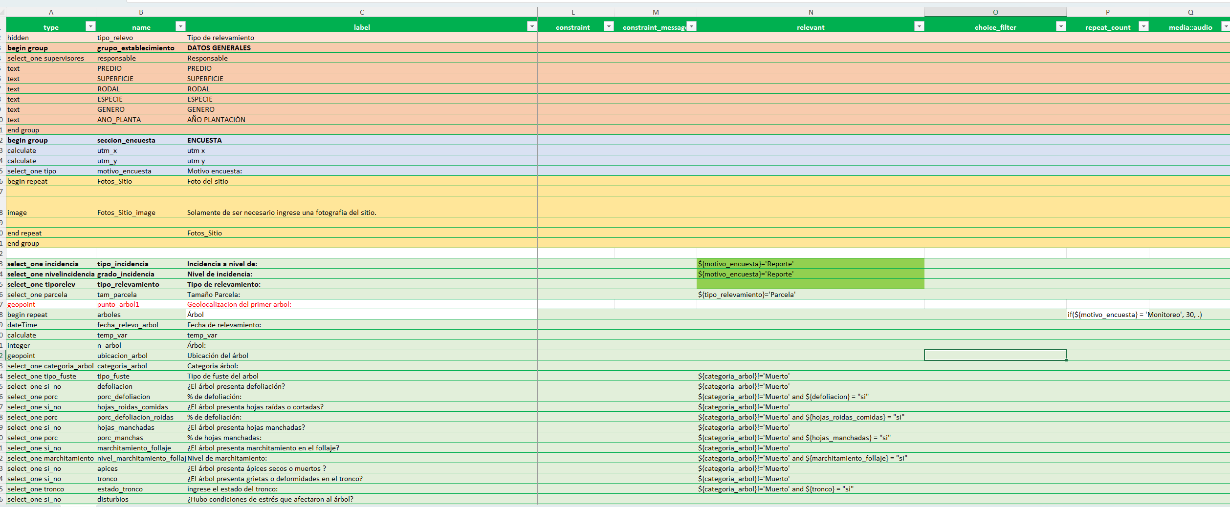

I have a form where I want to apply a restriction to a question within a repeat group (begin repeat). I'm trying to set it so that when 'motivo_encuesta' is answered with 'Monitoreo', the repeat at the tree level is exactly 30. If the answer is different, there should be no restriction on the number of entries. I'm using this formula: if(${motivo_encuesta} = 'Monitoreo', 30, .). However, for some reason, this is generating a circular reference, and I don't understand why, as I've reviewed the entire file.
