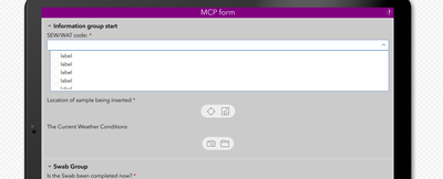

EdHixson
A little bit of progress, it is now just saying "label" for all of the values, I have tweaked where it was pulling the data form now within the linked content to the correct CSV file after downloading it through the linked content into the media.
I believe everything I have got set up in the choice is correct so am unsure why Label is the only option, especially since I have not mentioned label anywhere

Katie_Clark
MVP Alum
Regarding the "only label in the dropdown thing", make sure your CSV has the correct column headers, specifically name and label, all lowercase.

EdHixson
Hi Kathrine
Thank you for this, this is the first place ive found that mentions that you have to Name, Label as the column headers instead of your own choice of name.
Cheers
-Ed
Nicole_Ueberschär
It's also the first time that I see this. I believe if the CSV file does not have the name and label columns that you have to give the column name that has your choices in the name and label field in the choices sheet.
