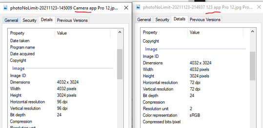

Can I ask what camera settings you mean?  I did some research and it says there are no user settings on an iPad.  Can you let me know where you see this?  Only things I have are Formats High Efficiency vs Most compatible.  The High Eff seem smaller and are stored at 92 DPI and no resolution unit.  Most compatible is at 72 DPI and does have resolution note.  Most compatible is larger - almost double.
All of these were tested with totally unrestricted size settings.
Next 123 is the one that is double the size here - sometimes that is.
The iPad Pro 11 and 12 both use the exact same camera as far as I can tell.  So why the total flip flop?
Here is on my Pro 12 inch it is 96 DPI from the camera but 123 is 72 bit.  Yet is 2X the size from 123.  I see resolution unit in there in the 123 side but not camera.  Maybe a mismatch?
I could for sure see some diff but for some to be double the size is something I have not seen before.

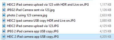

DougBrowning
MVP Esteemed Contributor
Thanks as always Phil.  I did a ton of testing today but its not consistent enough to report yet.  Diff iPads and Androids are giving different results.  Also results are diff today then last test.
So far using the 123 built in app or attaching a HEIC setting on image via a folder seems to be the smallest.
One thing I did notice is that all images are 72 DPI no matter where they are taken.  Except when I have HEIC on and use the iPad camera, then attach via the folder icon the image is 96 DPI.  Even though the original copy from the tablet is 72.  No idea why but maybe it is a clue?  All other images I take and attach or look at are 72.
iPad Pro 2020 12 inch numbers
I am tracking down more iPads that were causing us issues and that is taking some time.
Thanks again
