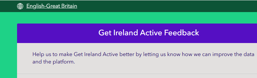

How can I fully remove a language on Connect? I added one just to test if it will be possible in the future (Gaeilge ga) but I want to remove it for now. I tried deleting the columns in the XLSF but the option still shows in the form. What I want is no option on the top left ... ie no reference to "English-Great Britain"

You mentioned Survey123 Connect, and it looks like you are using the web form for data collection. As such, I tried to recreate that.
Did you remember to delete all language references from the XLSX file?
For example, this:
Should be this:
And this:
Should be this:
After removing alllanguage references, you should change from this:
Back into this:

Thank you, that's exactly what I needed. Missed a couple of those and it's perfect now 🙂
