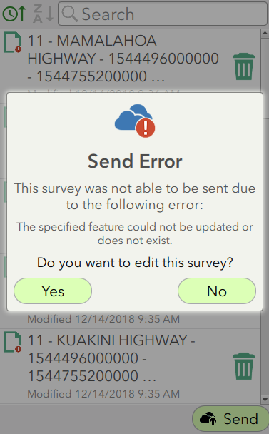

I have a feature service that was replaced by another and the previously stored survey data that pointed to the old feature service is sitting in Survey123 for ArcGIS.  I would like to resubmit the survey using from the updated form. Yet it is reporting that the survey feature does not exist or could not be updated.  I am able to load it into the new form, but it seems it does have the old feature Id embedded in.  How can I save these valid previously submitted survey data to save it in the new feature service?  I tried to use save as favorites and paste it, but the geopoints don't come through since they have repeats.
