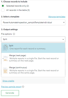

If you have multiple records selected in the Data tab of the ArcGIS Survey123 website you can include those records in one report under file options you can choose to merge them into a single file placing each record on the next page, or a continuous page.

Unfortunately not working, what are the changes to be done in template.  any guidance.

I collect information from survey like this
Record 1
1  user a valve hydrant temp
Record 2
2  user b valve 2 hydrant temp2
Need a single report in one page like a table. when using continuous  its not working.
id user   valveinfo  hydrant info temp
1  user a valve hydrant temp1
2  user b valve 2 hydrant temp 2
