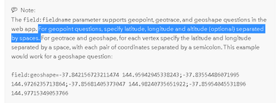

I am interested in capturing the lat/long of where they clicked (within the parcel, not where they are standing) in field maps and having that autopopulate in Survey123 as a geopoint question (though ideally a geoshape question where the parcel is pulled in, but as far as I know I would have to have the lat/long of every vertex within that polygon listed to accomplish that. Happy to be proven wrong).
How would I modify the custom URL above to accomplish autopopulating a geopoint question? Is there a way without an x/y field in the parcel layer?
