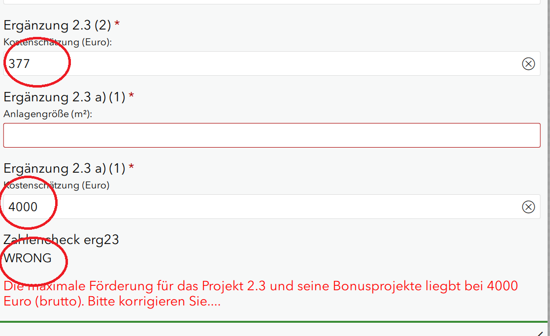

Dear users,
in my Survey123 Connect I want, that an error message appears if a specific values is > 4000.
That works quite good. I do a calculation for a "note-field" under the input fiels like: "if((${erg23} >4000),'WRONG','OK')"
But:

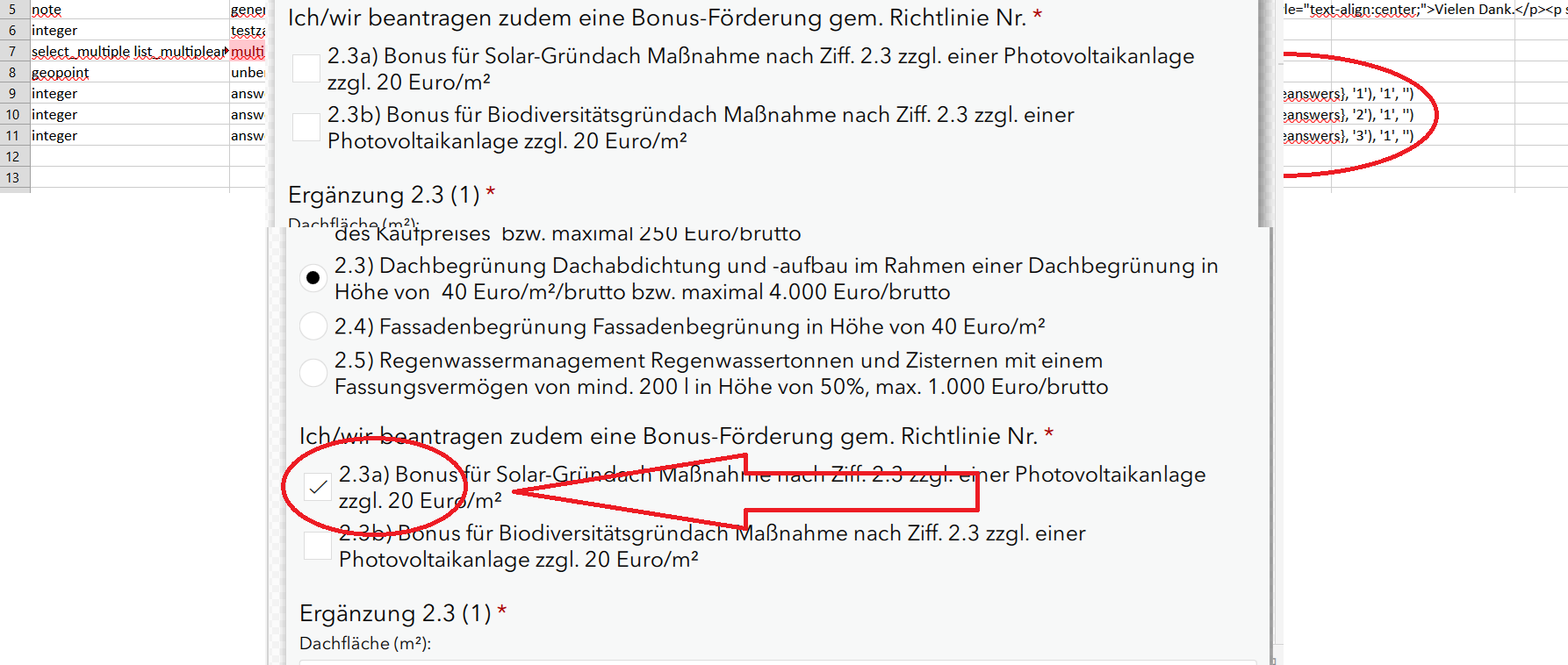

In my form people can open an addition calculation field, if the select a multiselection field:
At the end of the day I want to have a calculation like "if(((${erg23} + ${erg23a})>4000),'WRONG','OK')", so that the first value + "the sometimes values" are checked, if they are higher > 4000.

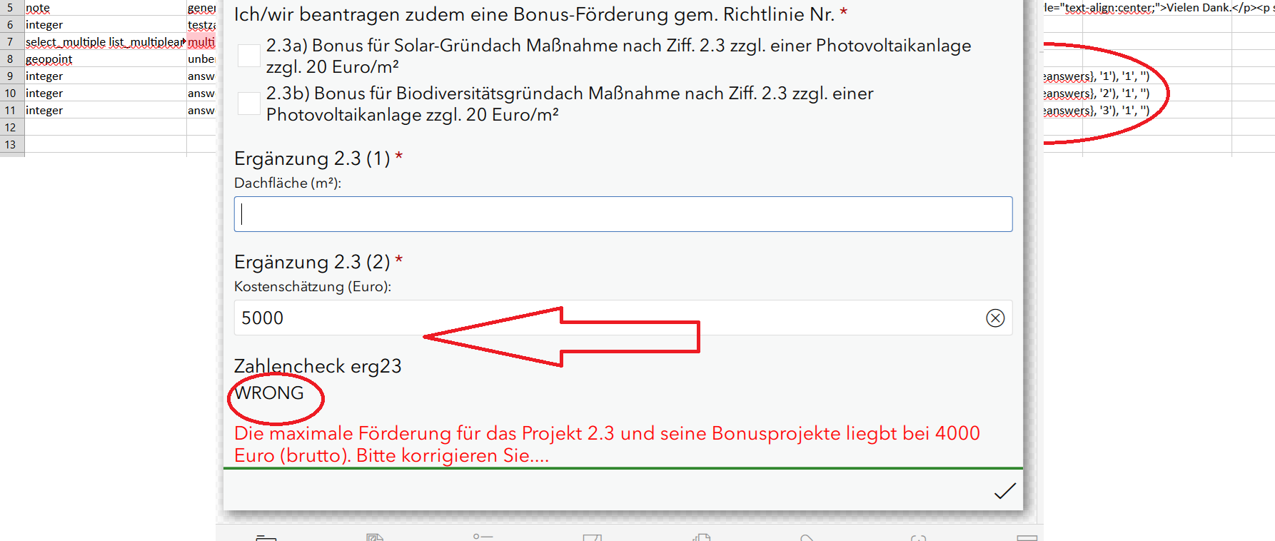

Well., that works, if both fields get a value:
But ""if(((${erg23} + ${erg23a})>4000),'WRONG','OK')"" does not work at all, if the second field is not integrated. Even if I put then "6000" in the first field (obviously > 4000) I dont`t get a Wrong-message. What can I do to add values to a calculation of fields, that only sometimes appear?
I need something like: "if(((${erg23} + if isset(${erg23a}=)>4000),'WRONG','OK')".
Has anybody an idea?
