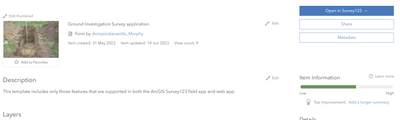

DionysiosKerasidis1
Hi Nicole
the below has resolved my issue, i was very naïve not to think of this. The entire work was done in survey123 Connect
https://support.esri.com/en-us/knowledge-base/error-warning-this-survey-has-already-been-published-t...
One thing i would like to ask you is how to you download the form from AGOL? i dont seem to have an option to download the form itself. I can open it but its still linked to the one saved locally.
Nicole_Ueberschär
Not sure if I get your question right. When you sign in into your ArcGIS Online account in Survey123 Connect you see all the surveys that were published together with the ones you designed maybe in Connect but did not publish. If the online version differs from your local version it should show an update button or if you don't have it locally then you see the download button. When I see the update option but I am not aware that any updates were made, I usually move the folder with that survey into a new location, reload the page and the download the survey to make sure that I am working on the latest version.
Does this answer your question?
