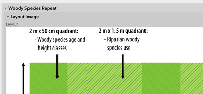

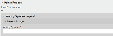

I came up with a work around using groups.  Still would love to see this as an option though.
I have an animation but over 5MB for attach which is really low.
Before
After
