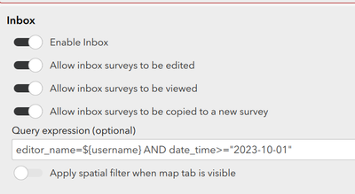

Thanks for the reply. That works but what if I need something more specific like the example in the Survey123 documentation ( Prepare to edit existing survey data—ArcGIS Survey123 | Documentation)

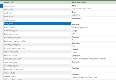

I tried this syntax and got the 400 error. The second image shows the properties of the dateTime field and the syntax that I used.

Does your data show year-month-day? Check your data for the date, my data shows like this
I would try 10/1/2023, if not work, then 10/1/2023 12:00 PM. So try different ways to express your date

Hi,

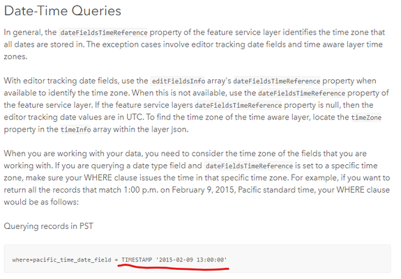

I tried those but didn't work either. But search on the developer's documentation I found the syntax: Query (Feature Service)—ArcGIS REST APIs | ArcGIS Developers
Thanks for your answers.
